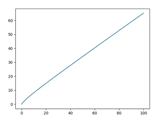

I wrote a python script to implement this, and it will instantaneously compute that there are $20795180176044632893334206971$ ways to win an award if the school year is $100$ days.
As you might expect, the values are roughly exponential. I plotted the logarithms of the values for $0\leq n\leq100$ and this is what I got:
