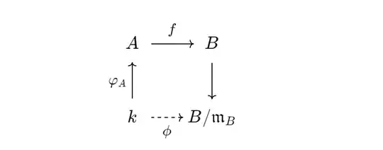

We have the following diagram:
We know all of the map are $k$-algebra homomorphism, therefore $\phi$ is $k$-algebra homomorphism from $k \to B/{\frak{m}}_{B}\cong k$. This map has to be identity map.
Therefore we have $A\to B/{\frak{m}}_B$ being surjective map, therefore by the first isomorphism theorem the kernel of this map has to be a maximal ideal, in the local ring is ${\frak{m}}_A$ therefore $f:A \to B$ maps ${\frak{m}}_A$ into ${\frak{m}}_B$
