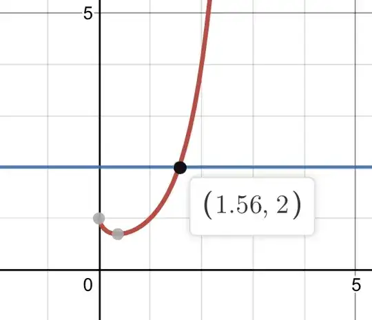

Also, here is a desmos answer to see this graphically:
However, there also exist other solutions using different branches of the predefined W(x) function with the link. Software is better explaining than I am. Here are the other solutions with the other branches as its inverse is a relation unless modified.
