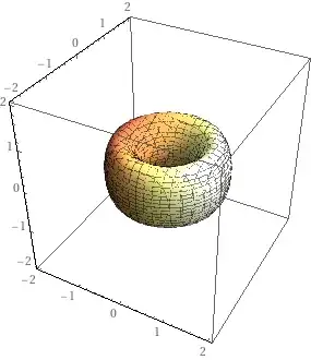

No. Consider the following function: $$ f(x,y,z)=(x^2+y^2-1)^2+z^2 $$ Note that $f^{-1}(\{0\})$ is the unit circle in the $xy$-plane, while $f^{-1}(\epsilon)$ is a torus around that circle for sufficiently small $\epsilon>0$. For instance, the $\epsilon=1/2$ case looks like this:
plot of level surface from wolframalpha.com
One can in fact obtain any oriented closed surface as the regular level set of a smooth function (see here for some examples).
As an aside, the unit disc (open or closed) is not applicable to this statement (since it concerns compact surfaces without boundary), and indeed the Gauss map of a disc need not be surjective.
