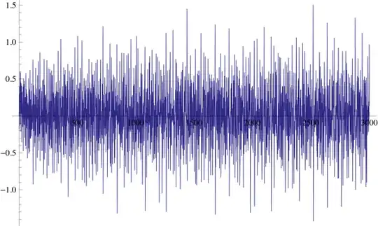

The error of the approximation in $(6)$ appears to be proportional to $n$. Here is a plot of that error, for $1\le n\le3000$, divided by $n$:
The error divided by $n$ has a mean of $-0.0746805451$ and a standard deviation of $0.6513592109$.

Using number theoretic functions, Marko Riedel's answer gives a better approximation. Here is a plot of the error of that approximation, for $1\le n\le3000$, divided by $n$:
The error divided by $n$ has a mean of $0.0060900069$ and a standard deviation of $0.3674311090$. This is better than the error distribution in my answer, but it does require factoring $n$ to compute the number theoretic functions.
