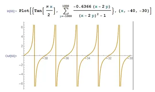

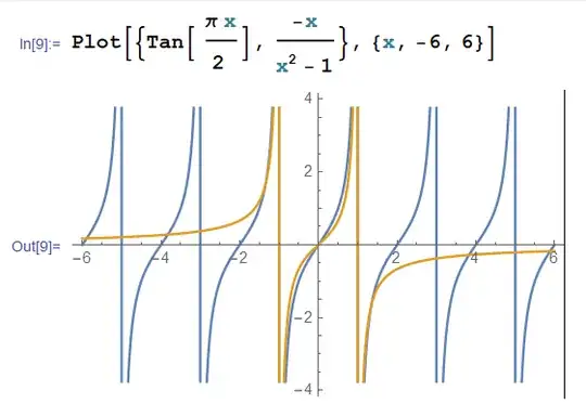

I wanted to approximate $\tan(x)$ as a rational function by capturing the zero at integer multiples of $\pi$ and poles at odd integer multiples of $\pi$. For convenience, I will be dealing with $\tan(\frac{\pi x}{2})$
$$\tan(\frac{\pi x}{2}) \approx \frac{x}{x^2-1} $$

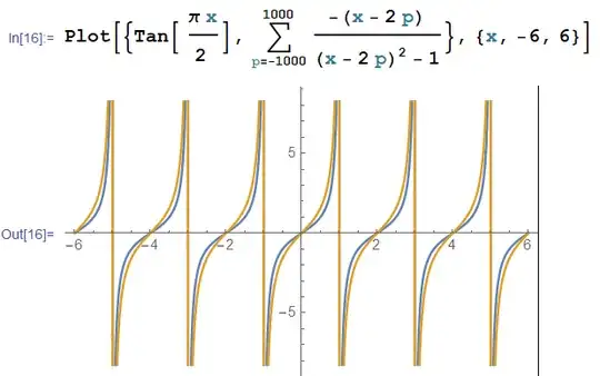

Now I will shift and sum this approximation for every even integer (where the zeros are - truncated)
Now I will multiply it by the constant $\frac{2}{\pi}$
I check the convergence away from the origin, seems to work
My question is: What is it that I'm doing here? There seems to be some validity to it. It might be converging for the whole complex plane.

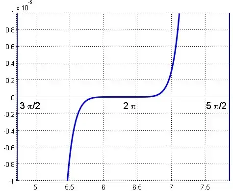

Fig. 1: Representation of the difference $y=h(x)-\tan(x)$ for $n=2$ showing that in the two-thirds of interval $(\frac32 \pi,\frac52 \pi)$, the absolute value of this difference is less than $10^{-5}$.

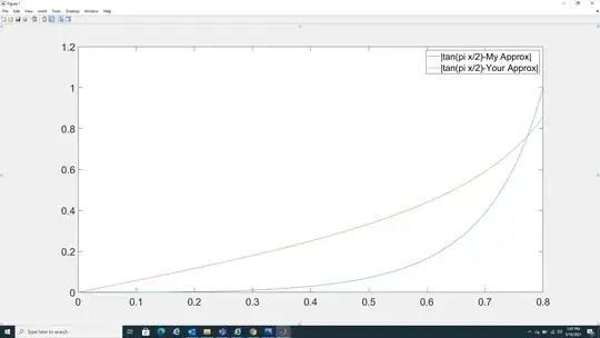

So if u use the approximation: $tan(\frac{\pi x}{4}) \approx \frac{\pi x}{4}$ (first term in Taylor series): $tan(2 \frac{\pi}{4} x) = \frac{-2 \times (\frac{\pi}{4} x)}{(\frac{\pi}{4} x)^2-1}$.
Close to what u have written/used. It works well for $0 \leq x \leq 0.8$ but doesnt work well for $x > 0.8 $: See the plot : enter image description here
