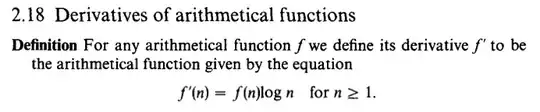

I'm reading Tom M. Apostol's introduction to analytic number theory. In chapter 2 he defines
derivative of arithmetical function

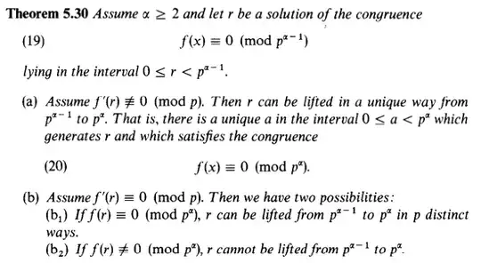

Does his definition apply to this modular polynomial in the question? I feel it does not. I'd think the derivative of the function in the question is just $f'(n) = 2n$. That's the formal derivative. I'm interested in knowing what $f'(n)$ is like in his theorem 5.30. What derivative is that?

    Since Apostol has called it a definition, it need not match what you call a formal derivative. – coffeemath May 14 '21 at 19:51
    This is a different kind of derivative. You can’t apply the real derivative to arithmetical functions, because they are only defined on $\mathbb N^+,$ so the real definition of derivative as a limit cannot be applied to arithmetical functions. – Thomas Andrews May 14 '21 at 19:52
    Please do not rely on images for text. They are not searchable (either within the site or by search engines), so future users will be unable to locate this post based on its content. They may not display properly for everyone. And screen readers cannot process them, which makes the post inaccessible to users who use screenreaders. The site has excellent mathematical typesetting capabilities, so please avail yourself of them. – Arturo Magidin May 14 '21 at 19:52
  • If I apply his definition to the polynomial in the question, I get $f'(n) = f(n) \log(n)$, so $f'(5) = 16\log(5)$, which is not an integer. – user851954 May 14 '21 at 19:59
    By the way, if $g(n)=(17n^2-9)\bmod 16,$ you’d have $g’(n)=34n,$ but $g(n)=f(n),$ so your definition of derivative would be not of a function, but of its written representation. – Thomas Andrews May 14 '21 at 20:45
The arithmetic functions are only defined on $\mathbb N^+,$ so you can’t use the calculus limit definition to get a standard derivative.
So in your case, you just apply the definition:
$$f’(n)=(n^2-9\bmod 16)\log n$$
