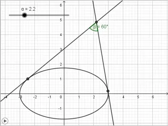

    From experimentation in geogebra there's a range $\alpha> 1.7$ (and $\alpha< -1.7$) for which the angle is acute. – Jan-Magnus Økland May 04 '21 at 18:03

Hint: $\alpha^4+\alpha^2-12=(\alpha^2-3)(\alpha^2+4)$ making the angle $\pi/2$ for $\alpha=\pm\sqrt{3}.$
Now check for say $\alpha\approx 2.2$ parabolaellipsetangentsangle

  • @aarbee You need to check that the square root exists (which it does outside the ellipse), and then it is clear that as $\alpha$ varies the angle changes from obtuse to acute at $\sqrt3$. Then it’s a matter of checking in which direction. Outside the ellipse but close to it the angle is obtuse as you can see by drawing it, or thinking that at the ellipse you start with a double tangent which has angle $\pi$. Far from the ellipse the angle is acute as you can check for a value or by using that the ellipse is bounded and the situation looks like chopsticks about an egg. – Jan-Magnus Økland May 06 '21 at 01:26

  • @aarbee $h^2-ab=27(3\alpha^4+\alpha^2-9)$ which has zeros for $\alpha\approx\pm 1.25435$ which does fit with the border of the ellipse. – Jan-Magnus Økland May 06 '21 at 07:01
  • Thanks, I had made a mistake in calculating $h^2-ab$, I have edited my post now. But I am sorry I am still not able to see why there would an acute angle for $\alpha\gt\sqrt3$. – aarbee May 06 '21 at 07:11
  • @aarbee See the edit. – Jan-Magnus Økland May 06 '21 at 07:33
  • Got it now, thankyou so much. – aarbee May 06 '21 at 07:48
