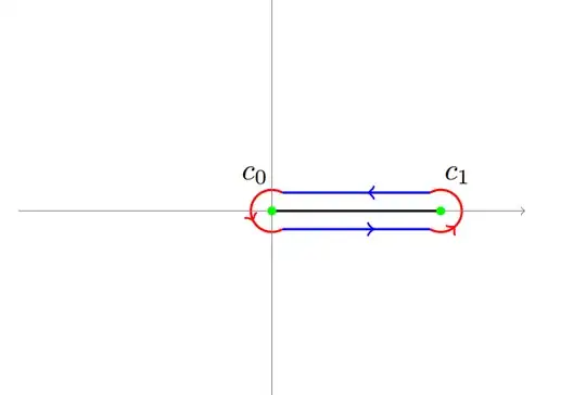

And in this interval our function is discontinuous since $e^{- i\pi} \ne e^0 = 1$. Thus I introduced a dogbone contour, namely $C$, aroud the branch $[0,1]$ such that:
$$C = \psi_1 \cup \psi_2 \cup c_0 \cup c_1$$
Where $\psi_1$ is the blue segment from $1$ to $0$ and $\psi_2$ is the blue segment from $0$ to $1$. (Thanks to @Zaid Alyafeai for the picture).

$\DeclareMathOperator*{\res}{Res}$
I see two errors in your derivation. First you try to sum the residues at $0$ and $\infty$. This is not correct because they are in different parts of the complex plane created by your contour.
We need in fact only the residue at infinity and this appears to be not zero. The simplest way to find the residue is to expand the function into Laurent series in the annulus $|z|>1$ where the function is analytic: $$ f(z)=\sqrt\frac{1-z}z=i\sqrt{1-\frac1z}=i\left(1-\color{red}{\frac12}\frac1z-\frac18\frac1{z^2}-\cdots\right), $$ so that $$ I=\frac12\oint_C f(z)dz=-\pi i \res_{z=\infty} f(z)=-\pi i\left(\frac i2\right)=\frac\pi2. $$
The above value can be easily verified by real integration using substitution $x=\sin^2\theta$: $$ \int_0^1\sqrt\frac{1-x}xdx=2\int_0^{\pi/2}\cos^2\theta\,d\theta=\frac\pi2. $$
