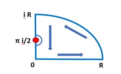

Using $\cos^2x=\frac{1+\cos2x}{2}$ $$I=\int_0^\infty\frac{\ln(\cos^2x)}{1+e^{2x}}dx =\int_0^\infty\frac{\ln(2+2\cos2x)}{1+e^{2x}}dx-2\ln2\int_0^\infty\frac{dx}{1+e^{2x}}$$ $$=\int_0^\infty\frac{\ln(1+e^{2ix})+\ln(1+e^{-2ix})}{1+e^{2x}}dx-\ln^22$$ $$I=2\Re\int_0^\infty\frac{\ln(1+e^{2ix})}{1+e^{2x}}dx-\ln^22=2\Re\,J-\ln^22\qquad(1)$$ To evaluate $J$ we consider the closed contour in the complex plane: enter image description here
The integrand does not have poles inside the contour, therefore $$\oint\frac{\ln(1+e^{2iz})}{1+e^{2z}}dz=0=J+I_R+\int_{i\infty}^0\frac{\ln(1+e^{2ix})}{1+e^{2x}}dx=J+I_R-i\int_0^\infty\frac{\ln(1+e^{-2t})}{1+e^{2it}}dt$$ where $I_R$ is the integral along the quarter-circle (of the radius $R\to\infty$), counter clockwise. The third integral includes integration along the small half-circles around the points $t=\pi i/2+2\pi i k, \,k=0,1,2...$, clockwise (the point $t=\pi i/2$ - as an example - is on the picture).
Integrating the third term by parts, $$\oint=J+I_R+\frac{1}{2}\ln(1+e^{-2t})\ln(1+e^{-2it})\,\Big|_{t=0}^{t=\infty}+\int_0^\infty\frac{\ln(1+e^{-2it})}{1+e^{-2t}}e^{-2t}dt$$ It is easy to show that $I_R\to0$ at $R\to\infty$ (please, see below) $$=I_R\,+\,2\Re\,J\,-\,\frac{\ln^22}{2}=0\qquad(2)$$ From (1), (2) follows: $$2\Re\,J=\frac{\ln^22}{2}\,\,\Rightarrow\,\,\boxed{\,\,I=2\Re\,J-\ln^22=-\frac{\ln^22}{2}\,\,}$$
