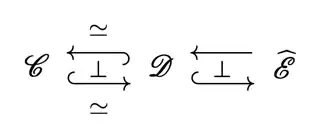

A Grothendieck topos is a left exact reflective subcategory of a presheaf category. Hence, since equivalences can be improved to adjoint equivalences, and are fully faithful, we can compose the equivalence with the reflection of $\mathscr D$ into a presheaf category.
lex reflection
Since equivalences preserve limits, $\mathscr C$ is therefore also a Grothendieck topos.
