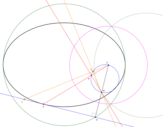

I haven't read the books suggested in the other answer, but I found a fairly simple proof - apologies if it is the same given there.
Suppose we have an ellipse with focus $F$ and a circle $c$ (pink in figure below) centred at $F$. To construct the polar line of a point $P$ on the ellipse, with respect to $c$, we can construct point $P'$, the circular inverse of $P$ with respect to $c$: the polar is then the line perpendicular to $FP$ at $P'$. The polar of the ellipse is the envelope of all the polars of $P$, as $P$ varies on the ellipse.
To construct the point on the envelope lying on the polar line of $P$, we can consider another point $Q$ on the ellipse, near to $P$: as $Q\to P$, the intersection of the polar lines of $P$ and $Q$ tends to a point $M$ on the envelope.
To find $M$, it is equivalent (but easier) to consider point $Q$ on the tangent at $P$ to the ellipse. If $Q'$ is the inverse of $Q$, then points $FP'Q'$ lie on a circle, which is the inverse of the tangent, and $M$ is the other endpoint of the diameter through $F$ (because $\angle FPM=\angle FQM=90°$). This means that $M$ is the inverse of point $H$, which is the projection of $F$ on the tangent.
But it is easy to prove (see here for a proof) that the locus of the projections of a focus on the tangents to an ellipse is its auxiliary circle, that is the circle having the major axis of the ellipse as diameter (solid green in the figure). Hence the polar of the ellipse, which is the locus of $M$, is indeed a circle: the inverse of the auxiliary circle with respect to $c$ (dashed green in the figure).
