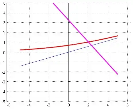

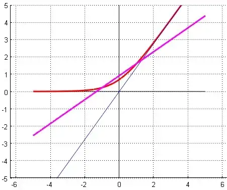

There is almost surely no closed form expression, but a qualitative approach is possible.
If $b=a$, there is clearly a solution. Let us assume $\dfrac{b}{a}>1$, WLOG.
Taking the natural logarithm of both sides of the given equation:
$$\operatorname{ln}(a^x (1+\left(\tfrac{b}{a}\right)^x)=\operatorname{ln}(c)$$
$$\operatorname{ln}(a^x)+\operatorname{ln}(1+\left(\tfrac{b}{a}\right)^x)=\operatorname{ln}(c)$$
$$-x\operatorname{ln}(a)+\operatorname{ln}(c)=\operatorname{ln}(1+\left(\tfrac{b}{a}\right)^x)$$
which represents the equation verified by the abscissas of the possible intersection point(s) of the straight line (L) (magenta on the figure) and curve (C) (red on the figure) with resp. equations:
$$\begin{cases}y&=&-x\operatorname{ln}(a)+\operatorname{ln}(c)\\ y&=&\operatorname{ln}(1+\left(\tfrac{b}{a}\right)^x)\end{cases}$$
Please note that the second curve has a slant asymptote with equation $y=x \ln(b/a)$.
Therefore, 3 cases can occur with 0, 1 or 2 roots,
according to the resp. values of $a,b,c$. One cannot have more than two roots because curve (C) can be shown to be convex, and a straight line cannot intersect a convex curve in more than two points.
Fig. 1: The given case $a=3;b=4;c=25$ with a unique root at $x=2$.
Fig. 1: The case $a=0.5;b=2;c=2.5$ with two roots $x=-1$ and $x=1$.
