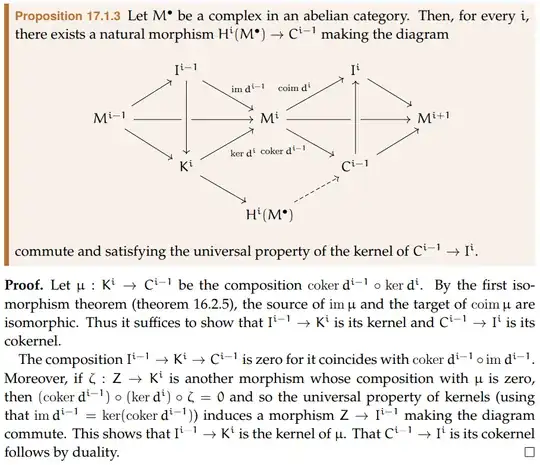

I indeed had misunderstood the part of Kashira-Schapira you meant. While I don't know if the general result you say is true, I'll try to explain how I understood the fact that $\operatorname{im}f\cong\operatorname{ker}u$ when I studied abelian categories.
If it interests you, you can find these notes here https://gabrielribeiro1707.wixsite.com/projects under "notes of everything".
