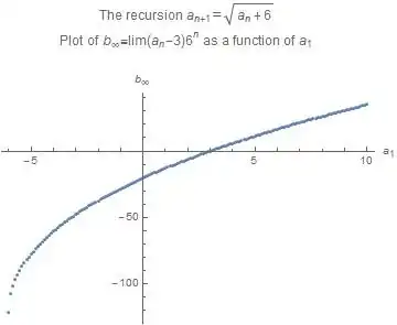

Limit as a function of the initial value
Here is a plot showing the dependence of the limit $b_{\infty}$ on the initial value $a_{1}$ for $-6 \le a_{1} <10$
Some special values of the limit are: $b_{\infty}(-6) = -121.164$, $b_{\infty}(0) = -20.1939$, and $b_{\infty}(3) = 0$
The limit function is well approximated by
$$b_{\infty}(a_1)=45.1116 (a_1+6)^{0.44966}-121.164\tag{7}$$
