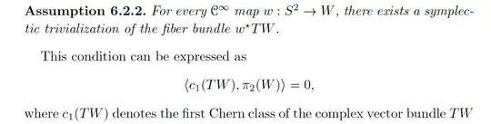

Suppose $E\to S^2$ be a complex vector bundle. If $c_1(E)=0$, does it imply that $E$ is a trivial bundle? And why if so? This question is motivated from Audin, Damian: Morse Theory and Floer Homology
