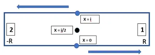

We choose the following contour in the complex plane:
To close the contour we also add two small half-circles ($C_1$ and $C_2$ above the point $x=0$ and below $x=i$ (we go counter clockwise in both cases) and vertical lines $1$ and $2$ at $R\to\pm\infty$
Integral along the closed contour looks $$\oint =I(a)+\int_{C_1}+\int_1+\,\,e^{ia-x}I(a)+\int_{C_2}+\int_2=2\pi i \operatorname{Res}_{x=\frac{i}{2}}\biggl(\frac{e^{ikx}}{\sinh^2 (\pi k) \cosh (\pi k)}e^{ak}\biggr)$$
It can be shown that $\int_1$ and $\int_2\, \to0$ at $R\to\infty$. We have a single pole of first order inside the contour at $x=\frac{i}{2}$, so $$I(a)(1+e^{ia-x})+\int_{C_1}+\int_{C_2}=-2\exp{(\frac{ia-x}{2})}$$
