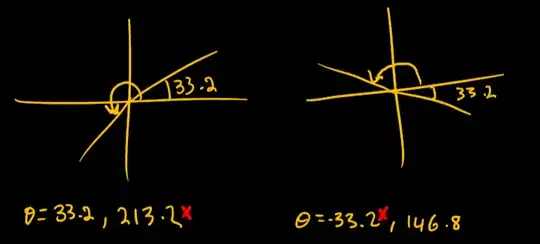

Then by using the quadrants quadrant
I was lead to the final solution that $x=33.2,146.8$ however the answer in the book has an additional solution of $x=90$, I understand the reasoning that $\tan(180)=0$ and $\cot(x)$ tends to zero as x tends to 90 however how was this solution found?

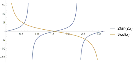

Perhaps this graph will help reveal the answers (abscissa in radians):
