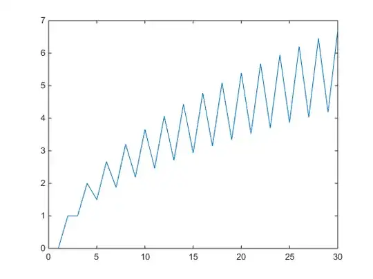

If you try the MATLAB code below
clc
clear
a(1)=0;
a(2)=1;
for i=3:30
    a(i)=1/a(i-1)+a(i-2);
   end;
plot(a)
then you will see the oscillatory behavior of the sequence. Like this: enter image description here
Are you sure that there is not a typo?

    It looks like $O(\sqrt n)$ which makes sense, at least to leading order – Empy2 Apr 05 '21 at 12:32
    Given one solution $f(n)$, another solution has $g(2n)=kf(2n),g(2n+1)=f(2n+1)/k$. There might be one value of $k$ that minimises the oscillation. – Empy2 Apr 05 '21 at 12:48
