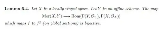

Edit:
For a simpler proof, maybe, I should use the following fact enter image description here
I can take the identity of $A_f$ (it represent the global section of $X$ and $Y$) and then show that the corresponding map between $X$ and $Y$ is an isomorphism of schemes.
