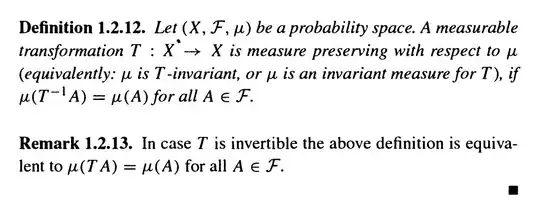

I am trying to prove the claim in Remark 1.2.13. : enter image description here which I can if I can prove the two following which I don't know how to prove them:
1- If $T$ is a measurable transformation and B a measurable set then $T[B]$ is a measurable set?
2- If $T$ is an invertible measurable transformation $T^{-1}$ is a measurable transformation too?
If any one of the two questions wrong, then I would need another proof for the mentioned remark in the text.
Please help. Thanks!

In all of the Ergodic books I've seen, it is assumed that the definition of invertible means that the inverse is measurable.

In general it is not true that bijective measurable maps are bimeasurable, see Measurability of the inverse of a measurable function. There it is shown that bijective measurable absolutely continuous maps are bimeasurable.
So let us let an invertible measure preserving transformation $f$ of a probability space $(X,\mu)$ stand for a bimeasurable bijection that preserves $\mu$ (which then implies the inverse also preserves $\mu$, as the Remark remarks).

  • So the q.2 is solved by assuming inverse to be measurable, and about q.1 I searched a lot but I think image of a measurable set under a measurable map need not be a measurable set (?) So the equivalence claimed in the remark of the book is valid? –  Mar 31 '21 at 19:08
  • q.1 and q.2 are equivalent. The remark is certainly false in general, but frequently, as both Alp Uzman and I commented, the dynamics literature defines invertible to mean that the inverse is measurable. – Andrew McMillan Mar 31 '21 at 20:07
