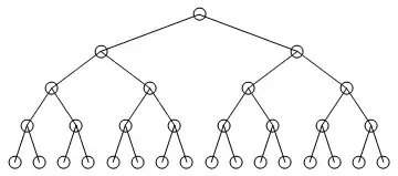

There exists arbitrarily large $2$-groups $G$ such that the center $Z(G)$ is cyclic of order two. A nice recursive construction of such is the wreath product tower $C_2$, $C_2\wr C_2$, $(C_2\wr C_2)\wr C_2$, $\ldots$. IIRC your background is more on the computer science side, so it may be easier for you to get a handle of these as groups of graph automorphisms $G_n$ of the full binary tree $BT(n)$ of $n$ levels (so $2^n$ leaves). Like $n=4$: enter image description here
It is easy to convince yourself of the fact that an automorphism of this graph must permute the $16$ leaves (the leaves are the only nodes of valence $1$). Also, an automorphism is fully determined if we know how it acts on the leaves. Furthermore, an automorphism must either intechange the two halves (two copies of a $3$-level binary tree), or be an automorphism of both half-trees. Consequently $$ G_n=(G_{n-1}\times G_{n-1})\rtimes C_2 $$ with the extra factor $C_2$ being the cyclic group generated by "the halves changing automorphism" that we can specify to be the reflection w.r.t. the vertical axis of symmetry. This is what the above wreath product tower means.
Anyway, we see that
  1. The orders of the groups $G_n$ satisfy the formula $$|G_n|=2|G_{n-1}|^2.$$ Clearly $|G_1|=2$ (a cyclic group), so $|G_2|=8$ (the dihedral group $D_4$), $|G_3|=128$, $|G_4|=2^{15}$ et cetera.
  2. For an element $g$ of $G_n$ to be in the center, it has to commute with the halves changing reflection as well as any tiny perturbation of one of the halves. The latter forces $g$ to be in the subgroup $G_{n-1}\times G_{n-1}$ that map the two half-trees to themselves. For its part, the former then forces $g$ to have the mirror image effect on both halves, so $g=(g',g')$. Then the latter requirement again forces $g'$ to be in the center of $G_{n-1}$. A simple piece of recursive thinking then forces $g$ to be the automorphism that swaps all the pairs of leaves sharing the same parent. The conclusion is that $Z(G_n)\simeq C_2$.
  3. I asked about the non-abelianity of these groups from a different direction in this question, where I queried about the size of the group $G_n/[G_n,G_n]$. Knowledgable commenters told me that my hunch is correct and $|G_n/[G_n,G_n]|=2^n$. This tells us that the largest abelian homomorphic image of $G_n$ has $2^n$ elements.
