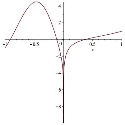

Complex values allowed...
Define $$ x^x = \exp\big(x\log x\big) $$ using the principal value of $\log x$. Undefined at $x=0$.
Then the derivative is $$ \frac{d}{dx}\; x^x = x^x (1+\log x) $$ Here is the real part of the derivative
RE
It is continuous, except at $x=0$, where it goes to $-\infty$.

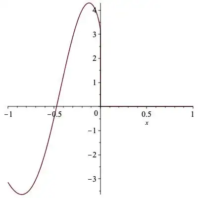

Here is the imaginary part of the derivative
IM
It is continuous, except at $x=0$, where it jumps from $\pi$ to $0$.
