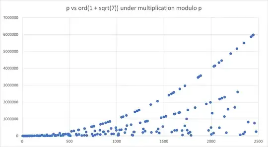

I noticed the order of $1 + \sqrt 7$ in my group is usually of the form $\frac{p^2 - 1}{d}$ where $d$ is some positive integer divisor.
For example, operating under mod $p := 5$: $5^2 - 1 = 24$ and $\mathrm{ord}\left(1 + \sqrt 7\right) = 12 = 24/2$.
I plotted the order of $1 + \sqrt 7$ under different values of $p$ and here are the results: enter image description here You can easily see the patterns emerge (i.e. broken parabolas in the plot):
  • $p^2 - 1$
  • $(p^2 - 1)/2$
  • etc.
Why does this happen? Is there a reliable way to predict when this happens and even what the divisor would be? This could potentially provide an efficient way to calculate the order of my group element.
    There are $p^2-1$ pairs $\langle a,b\rangle$ with at least one of $a, b\neq 0\pmod p$; since that's the order of the group, the order of a subgroup (in this case, the subgroup generated by $1+\sqrt{7}$) must divide it. – Steven Stadnicki Mar 23 '21 at 05:56

  • That makes sense, thank you. My algebra is definitely rustier than I thought. So the generator $1 + \sqrt 7$ makes a subgroup of $G$ and Lagrange's Theorem states the order of a subgroup divides $|G|$. The order of the original group $G$ is $p^2 - 1$ because of your counting argument. Is my understanding correct? – Tristan Batchler Mar 23 '21 at 07:39
  • If the number 7 is a quadratic residue modulo p, then the order m of 1+\sqrt7 divides p-1, otherwise m divides the number p^2-1.For instance, if p=19, 29, 31, 37 then m=9, 14, 15, 9, respectively. – kabenyuk Mar 23 '21 at 09:58

Let's make the situation a bit more precise by working over the finite field $\Bbb{F}_p$ of $p$ elements. Adjoining $\sqrt{7}$, a root of $X^2-7\in\Bbb{F}_p[X]$, then yields a field extension $\Bbb{F}_p\subset\Bbb{F}_p[\sqrt{7}]$, and its degree is either $1$ or $2$. The degree is $1$ if and only if $X^2-7\in\Bbb{F}_p[X]$ has a root in $\Bbb{F}_p$, or equivalently, if $7$ is a quadratic residue mod $p$. By quadratic reciprocity it follows that the degree is $1$ if and only if $$p\equiv1,2,3,7,9,25,27\pmod{28}.$$ In this case $\Bbb{F}_p[\sqrt{7}]=\Bbb{F}_p$ with unit group $\Bbb{F}_p^{\times}=\Bbb{F}_p-\{0\}$, so the invertible elements form a group of order $p-1$. Otherwise $\Bbb{F}_p[\sqrt{7}]\cong\Bbb{F}_{p^2}$, and the invertible elements form a group of order $p^2-1$. Note that in either case this group is cyclic; see this question for a proof.
As far as I can tell there is no quick method to determine the order of an element. A closely related problem is finding a primitive root mod $p$, which is hard in general. But here are a few simple observations:
  1. If $7$ is a quadratic residue mod $p$, then the order of $a+b\sqrt{7}$ divides $p-1$.
  2. If $b\equiv0\pmod{p}$ then $a+b\sqrt{7}\in\Bbb{F}_p$ and so the order divides $p-1$.
  3. If $7$ is not a quadratic residue and $b\not\equiv0\pmod{p}$, then the order of $a+b\sqrt{7}$ does not divide $p-1$. Moreover $(a+b\sqrt{7})^{p+1}\in\Bbb{F}_p^{\times}$, so you can first find a divisor $d$ of $p+1$ such that $(a+b\sqrt{7})^d\in\Bbb{F}_p^{\times}$, and then use point $1$. Note that $\gcd(p-1,p+1)=2$ so you may need to take out a factor $2$.
Another approach might be to consider that $1+\sqrt{7}$ is a root of $X^2-2X-6$. Then for each prime number $p$, you want to find the minimal positive integer $d$ such that $X^2-2X-6$ divides $X^d-1$, or better yet the $d$-th cyclotomic polynomial $\Phi_d$, as polynomials in $\Bbb{F}_p[X]$. The ideas above already give some restrictions on $d$.
