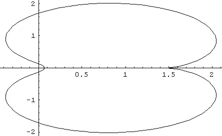

Neutral Fixed Points in Tetration
$e^{e^{2 \pi i x-{e^{2 \pi i x}}}}$

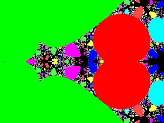

Tetration Mandelbrot Fractal
\begin{eqnarray} {}^t a = a_o & + & \lambda ^t\left(1-a_o\right)+\frac{\lambda ^{-1+t} \left(-1+\lambda ^t\right) \text{Log}\left(a_o\right){}^2}{2 (-1+\lambda )}\left(1-a_o\right){}^2 \\ & + &\frac{1}{6}\text{ }\left(\frac{3 \lambda ^{-2+t} \left(-1+\lambda ^t\right) \left(-\lambda +\lambda ^t\right)\text{ }\text{Log}\left(a_o\right){}^4}{(-1+\lambda )^2 (1+\lambda )}\\ +\frac{\lambda ^{-1+t} \left(-1+\lambda ^t\right) \left(1+\lambda ^t\right)\text{ }\text{Log}\left(a_o\right){}^3}{(-1+\lambda ) (1+\lambda )}\right)\left(1-a_o\right){}^3+\ldots \end{eqnarray}
