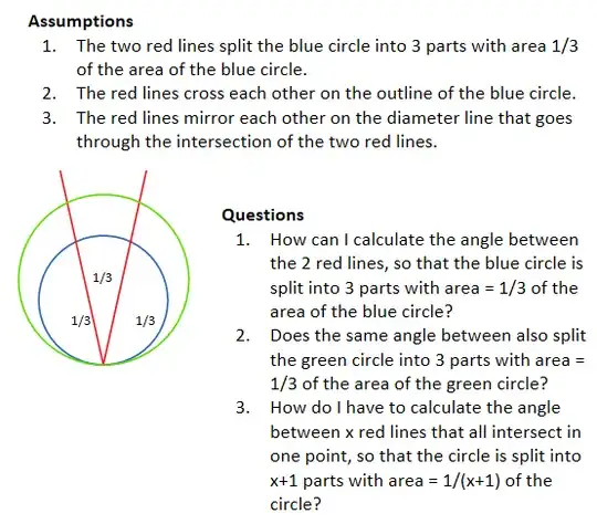

The picture probably explains my question best.
I need to find a way to divide a circle into 3 parts of equal area with only 2 lines that intersect each other on the outline of the circle.
Also I need to check, if whatever diameter is between those lines, also splits circles with a different diameter into equal parts.
And lastly, and probably the most difficult question: How do I have to calculate the angle between x lines that all intersect in one point, so that the circle is split into x+1 parts with area = 1/(x+1) of the circle?
I tried my best, but couldn't even find a single answer or the right strategy to tackle the question...
- Yes. If you find the red lines so that they divide the blue circle into 3 parts of equal areas, then the green circle is also dividd into 3 equal parts.

To find the angle $x$ between the red lines you need to solve the equation $$\sin(x)+x=\frac\pi3.\tag1$$ This can be done only numerically.
Yes it divides also the green circle in three equal parts.
Observe the essential difference between the cases with even and odd $n$. Whereas in former case the diameter drawn from the common intersection point is one of the "red" lines, in the latter case it is the bisector of the central angle. Let $x_k$ be the angle of a red line with the diameter. Then the following are the equations to find $x_k$: $$ x_k+\frac12\sin2x_k=\frac\pi{n}k, \quad\text{with}\quad k=-\frac n2+1\dots \frac n2-1.\tag2 $$ Observe that the numbers $k$ are integer for even $n$ and half-integer for odd $n$. For $n=3$ the equation $(2)$ reduces to $(1)$ with $x=2x_\frac12$.

I computed the area of the middle part ($x $ is the angle between the lines) and equated the result to one third of the circle area. – user Oct 28 '23 at 09:12

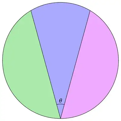

Given the angle $\theta$, split by the diameter containing $B$, consider the following diagram:

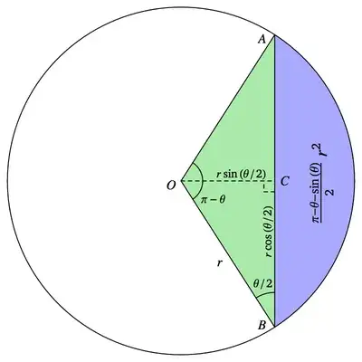

$\overline{BO}$ is the line through the center and $\overline{BA}$ is the chord cutting off the lune whose area we wish to compute.
The area of the circular wedge subtended by $\angle BOA$ is $$ \frac{\pi-\theta}2r^2\tag1 $$ The area of $\triangle BOA$ is $$ \frac12\cdot\overbrace{r\sin\left(\frac\theta2\right)}^\text{altitude}\cdot\overbrace{2r\cos\left(\frac\theta2\right)}^\text{base}=\frac{\sin(\theta)}2r^2\tag2 $$ Therefore, the area of the lune is $(1)$ minus $(2)$: $$ \frac{\pi-\theta-\sin(\theta)}2r^2\tag3 $$ To get the area divided into thirds, we want $$ \frac{\pi-\theta-\sin(\theta)}2r^2=\frac\pi3r^2\tag4 $$ which means we want to solve $$ \theta+\sin(\theta)=\frac\pi3\tag5 $$ whose solution can be achieved numerically (e.g. use $M=\frac\pi3$ and $\varepsilon=-1$ in this answer) $$ \theta=0.5362669789888906\tag6 $$ Giving us

If you mean the area $\frac{\pi-\theta}2r^2$ in $(1)$, that is because $\angle BOA=\pi-\theta$, and the area of a sector with angle $\alpha$ of a circle with radius $r$ is $\frac\alpha2r^2$. – robjohn Oct 28 '23 at 10:32
