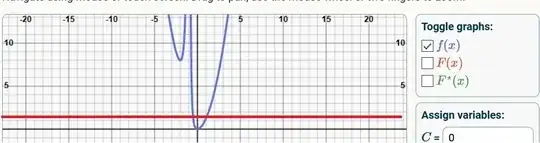

First I derived the minimums of $f(x)$. Very easy task finding $x=-2$ and $x=0$
Then by simple inspection (I spent 30'' to do that) immediately find that the range such that $f(x)<1.25$ is given by
$$x \in (-0.5;1)$$
The suggested graphical method is easy too...
the red line is $y=5/4$
the blue line is the graphics of your $f(x)$
to calculate the two bounds I think it is evident that
$$f(1)=1+\frac{1}{4}=\frac{5}{4}$$
$$f(-0.5)=\frac{1}{4}+1=\frac{5}{4}$$
