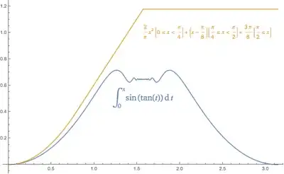

Equation $(1)$ implies that, for all $x\in[0,\pi]$, $$ I(\pi-x)=I(x)\tag4 $$ Since $\sin(\tan(x))$ has period $\pi$ and $(1)$ says that its integral over $[0,\pi]$ is $0$, $I(x)$ also has period $\pi$. That is, $$ I(\pi+x)=I(x)\tag5 $$ Furthermore, on $\left[0,\frac\pi4\right]$, $\tan(x)$ is convex; therefore, $\tan(x)\le\frac4\pi x$. Since $\sin(x)\le\min(x,1)$, we also have that $\sin(\tan(x))\le\min\left(\frac4\pi x,1\right)$. Thus, $$ I(x)\le\frac2\pi x^2\left[0\le x\lt\tfrac\pi4\right]+\left(x-\frac\pi8\right)\left[\tfrac\pi4\le x\lt\tfrac\pi2\right]+\frac{3\pi}8\left[\tfrac\pi2\le x\right]\tag6 $$ enter image description here
