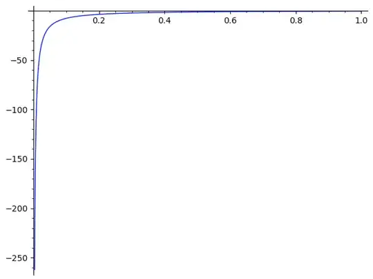

Showing this function is convex is certainly tedious, but the tedium is remedied somewhat by the use of a computer algebra system such as sage.
Indeed, we can try
sage: f(x) = (1+1/x)^x
sage: secondDerivative = diff(f,x,2)
x |--> (1/x + 1)^x*(1/(x*(1/x + 1)) - log(1/x + 1))^2 - (1/x + 1)^x/(x^3*(1/x + 1)^2)
sage: plot(secondDerivative)
plot the second derivative
This certainly seems to be negative everywhere, but we should confirm the behavior as $x \to 0^+$ and as $x \to \infty$.
sage: lim(secondDerivative, x=0, dir='+')
x |--> -Infinity
sage: lim(secondDerivative, x=oo)
x |--> 0
