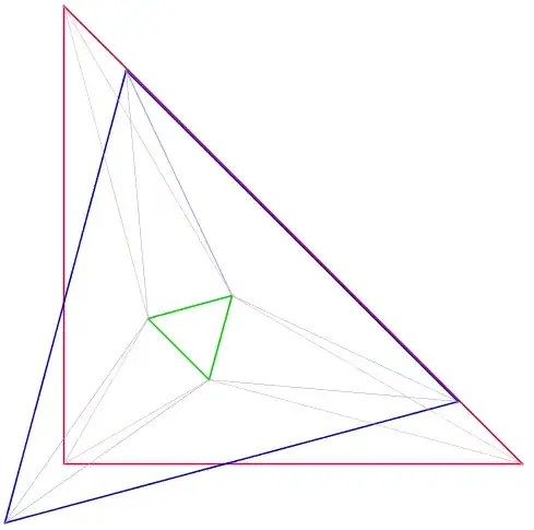

I will take the question in the title:
Can you go backwards from a Morley triangle?
The simple answer is no. Start with any asymmetric triangle, and find its Morley triangle. There is an equilateral triangle which also gives the same Morley triangle (just put a triangle with angles $4\pi/9$, $4\pi/9$, and $\pi/9$ on each edge of the Morley triangle to find its vertices), so the Morley triangle does not define the shape of the original triangle.
An example of an equilateral triangle and a half-square with the same Morley triangle: Morley triangle
