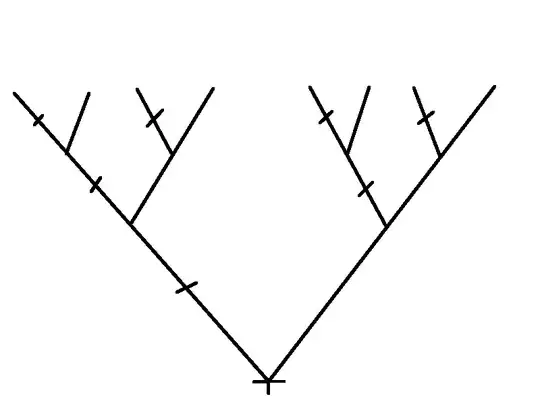

Basically, we want to associate to each set $A$ of paths through the infinite binary tree (there are $2^{2^{\aleph_0}}$-many sets of such paths) an $X_A\subseteq\mathbb{R}^2$ which is connected and such that $A\not=B$ implies $X_A\not\cong X_B$. The first step to doing this is to build a copy of the complete binary tree inside $\mathbb{R}^2$, in a "topologically-decodable" way. For example:
Here the root of the tree is recognizable as the only degree-five point, and we can distinguish left and right via the degree-four points (the little hash marks in the middle of the left-pointing edges). Of course I've only drawn the first few branchings of the tree.
Now we attach, to the "end" of each path through this infinite tree, a copy of $[0,1]$ or $[0,1)$ depending on whether the infinite binary sequence representing that path is in $A$
This is all a little vague; it's a good exercise to fill in the details. Note that the sets so constructed are topologically quite nice in may ways (e.g. contractible, and locally homeomorphic to $\mathbb{R}$ except on a nowhere-dense set).
