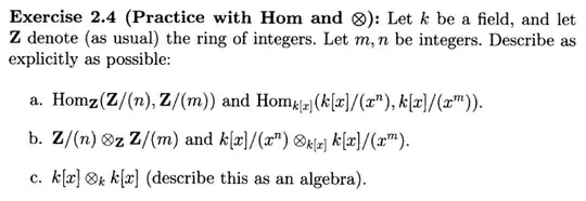

I finished doing Exercise 2.4 from Eisenbud: Commutative Algebra, with a View Toward Algebraic Geometry, and I was wondering if I could have someone look over my solutions to check if everything is correct. Thanks!
(If someone can just tell me if my answers are correct or not, without checking the proofs, I would appreciate that too!)
I will write my solution to each problem in separate bullets, with their justifications immediately below.
