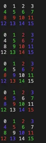

EDIT
In response to user's comments.
I thought of a way to present this that might make it a little clearer. In each group, the $16$ numbers represent the points of the plane, and points of the same color lie on the same line. In the first two groupings, this looks pretty dull; the lines are rows or columns. In the last three groupings, the lines don't look like what we normally think of as lines, but they satisfy the same kind of linear equations as the lines you're used to.
This isn't the place to try to explain that. You can search the Web for "finite geometries", but you'll have to learn a little bit about finite fields before it makes sense.
