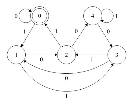

We can use the happy face of five-divisibility!
Start in state $0$. Follow the appropriate arrows as you read digits from your binary number from left-to-right. If you end up in state $0$ again your number is divisible by $5$ (and if not, the state number gives you the remainder).
How does it work? Well if we're in state $k$ it means the digits we have read so far form the number $n$ with remainder $k \equiv n \mod 5$. If we then read another digit $b$, we effectively move to the new number $n' = 2n + b$. Thus we need to move to state $(2k + b) \bmod 5$, which is exactly what we do in the above graph. Thus if we end up in state $0$ in the end we know there is no remainder, and the number that we read is divisible by $5$.
The state diagram above is just this logic graphically displayed. You could have it as a table instead as well:
\begin{array}{ccc} k & b & 2k + b & (2k + b) \bmod 5\\ \hline 0 & 0 & 0 & 0 \\ 0 & 1 & 1 & 1 \\ 1 & 0 & 2 & 2 \\ 1 & 1 & 3 & 3 \\ 2 & 0 & 4 & 4 \\ 2 & 1 & 5 & 0 \\ 3 & 0 & 6 & 1 \\ 3 & 1 & 7 & 2 \\ 4 & 0 & 8 & 3 \\ 4 & 1 & 9 & 4 \\ \hline \end{array}
This also makes for a nice mental rule. You start with the number $0$ in your head and look at the digits from left-to-right. For each digit you multiply the number in your head by $2$ and add the digit you just read. If the number goes to five or above you subtract five. If you end up with $0$ the number is divisible by $5$.
