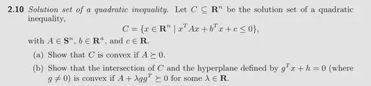

I'm doing part (a) problem 2.10 in textbook Convex Optimization by Boyd and Vandenberghe:
Let $C \subseteq \mathbf{R}^{n}$ be the solution set of a quadratic inequality,
$$ C=\left\{x \in \mathbb{R}^{n} \mid x^{T} A x+b^{T} x+c \leq 0\right\} \\ $$
with $A \in \mathbb{S}^{n}$, $b \in \mathbb{R}^{n}$, and $c \in \mathbb{R}$.
(a) Show that $C$ is convex if $A \succeq 0$.
