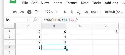

On the topic of finding $h(p)$ for $p$ prime: Trisano periods exist for all $p$ (that's Waddill's Theorem 1), however they are no more predictable than Pisano periods are for Fibonacci sequences. One can only compute as many terms as needed to find the first reoccurrence of the first terms. For small primes, using a spreadsheet is fast and simple:
Trisano formula
Column A for the indices, column B for the sequence itself, cell D1 for the modulus. Then you copy A4:B4 down a few hundred times, and you will find a new occurrence of $0,1,1$ at index $168$.
