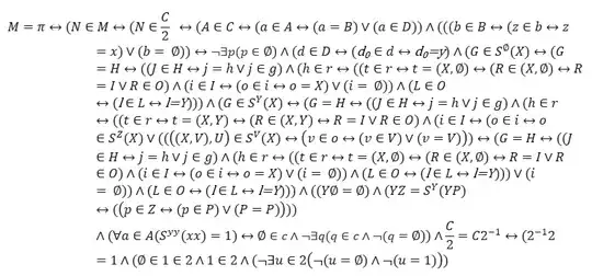

-2
I wrote the original equation in Word and added it here
dantopa
  • 10,768
Master
  • 233
