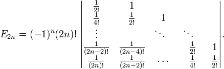

How to prove that
where $\ E_{2n}$ is the $2n^{th}$ euler number
and $$\frac{1}{\cosh(x)}=\sum_{n=0}^{\infty }\frac{E_n}{n!}x^n$$
Is there maybe some link with an answer, or a book in which the above is shown?
mnsh
  • 5,991
We have $\cosh (x) \cdot \frac{1}{\cosh (x)} = 1$ and $\cosh (x) = \sum_{k=0}^\infty \frac{1}{2k!}x^{2k}$. Multiplying and taking the coefficient of $x^{2n}$ we arrive at $E_0 = 1$ and $\sum_{k=0}^n \frac{1}{2k!}\cdot\frac{E_{2n-2k}}{(2n-2k)!} = 0$ for $n \geq 1$. From here on this is a straight forward proof by induction.
