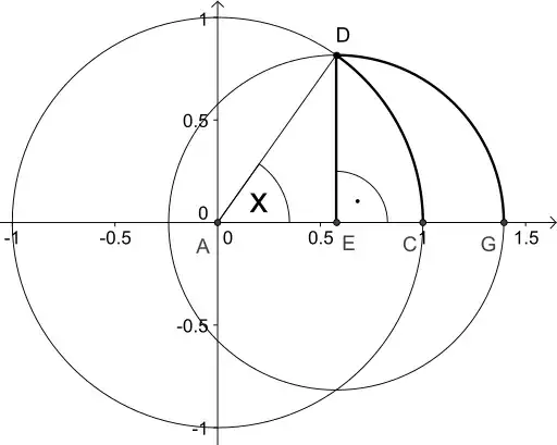

The following is taken from Wikipedia: Jordan's inequality where it is attributed to
  • Yuefeng, Feng. “Proof without Words: Jordan's Inequality 2x/π ≤ Sin x ≤ x, 0 ≤ x ≤π/2.” Mathematics Magazine, vol. 69, no. 2, 1996, pp. 126–126. JSTOR, https://www.jstor.org/stable/2690669.
(File: https://commons.wikimedia.org/wiki/File:Jordans_inequality.svg, Attribution: Kmhkmh, CC BY 3.0 https://creativecommons.org/licenses/by/3.0, via Wikimedia Commons.)
The arc from $C$ to $D$ on the unit circle has the length $x$, and the arc from $G$ to $D$ on the circle with radius $\sin(x)$ has the length $\frac \pi 2 \sin(x)$. It follows that $$ x \le \frac \pi 2 \sin(x) \iff \frac 2 \pi x \le \sin(x) \, . $$
