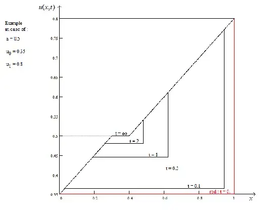

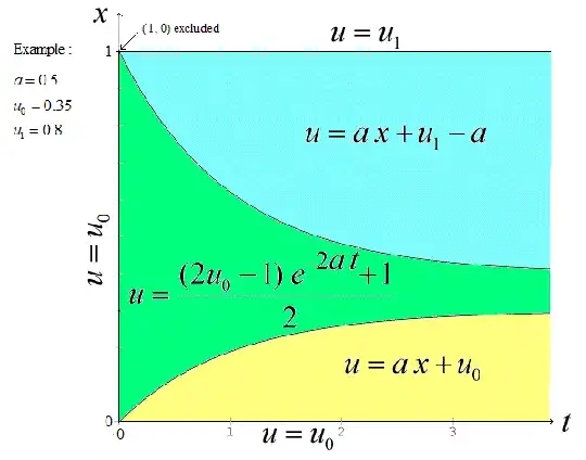

With piecewise functions they are a lot of different cases depending on the values of $u_0,u_1,a$. For exemple the schematic below gives a rough idea of the behaviour.
Along the border $x=0$ we have $U_t=0$. This is the case of constant above function $G$.
Along the border $x=1$ we have $U_t=0$. Again the function $G$ is constant, but different.
Along the border $t=0$ we have $U_x=0$. This is the case of constant above function $F$. In other words : $u(x,0)=u_0\quad\implies\quad (2u_0-1)=F(u_0-ax)$. This is possible only if $F$ is a constant function : $F=2u_0-1$. Thus $\quad (2u-1)e^{2at}=2u_0-1$ and the solution is : $$u=\frac{(2u_0-1)e^{-2at}+1}{2}.$$
On the transition line which separates the fields green and blue on the figure, the function $u(x,t)$ is discontinuous. The values of $u$ are not equal on both sides of the line.
Below another presentation of the same example shows what happens for $t\to\infty$ in this case. The shapes can be different for other values of $a,u_0,u_1$.
Note that the above figures are not to intend to explain all cases. More work would be necessary for different cases depending on the values of $u_0,u_1,a$.
