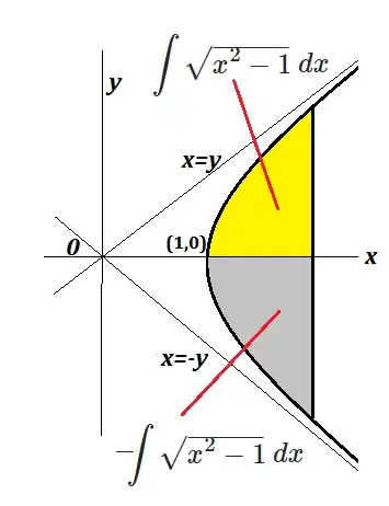

Also by means of a definite integral we compute both areas, above and below x-axis shown yellow and gray , in geometric areas representation for the equiangular hyperbola:
