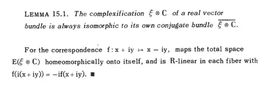

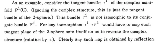

If a complex vector bundle is constructed by the complexification of a real vector bundle, say $E=F\otimes \mathbb{C}$, then there's a conclusion that $E$ is isomorphic to its conjugate bundle by setting $f: x+iy \to x-iy$. However, usually a complex bundle is not isomorphic to its conjugate bundle. So what's the intrinsic difference between them? I'm reading the section on Pontrjagin classes in Milnor and Stasheff's "Characteristic Classes" and I am a little confused.

Thank you, I mean every complex vector space can set a map f like the above, but why the above proof does not hold for other complex bundles? – Sunhf Jan 16 '21 at 15:18

3Writing down a conjugation map on $V$ is equivalent to expressing $V$ as the complexification of a real vector space, see this answer. – Michael Albanese Jan 16 '21 at 15:50
Thank you very much ! I think I've got the main problem in it. Although we can define conjugation on every complex space, there isn't a canonical way to define a continuous conjugation map like above on the whole vector bundle. For example, a conjugation conjugation map like above means there's a n-dimensional real vector bundle embedded in the underlying 2n-dimensional real vector bundle, but we can not always find a n-dimensional real vector bundle embedded in a 2n-dimensional vector bundle. – Sunhf Jan 17 '21 at 15:34

A complex conjugation on a complex vector space $V$ is an antilinear map $\sigma : V \to V$ such that $\sigma\circ\sigma = \operatorname{id}_V$; note that $\sigma$ induces an isomorphism $V \to \overline{V}$. Choosing a complex conjugation on $V$ is equivalent to choosing an isomorphism between $V$ and the complexification of a real vector space; see this answer. Every finite-dimensional complex vector space $V$ admits a complex conjugation because $V \cong \mathbb{C}^n$ for some $n$ and $\mathbb{C}^n\cong\mathbb{R}^n\otimes_{\mathbb{R}}\mathbb{C}$.
By the same argument as above, a complex vector bundle admits a complex conjugation (and hence is isomorphic to its conjugate bundle) if and only if it is the complexification of a real vector bundle. However, not every rank $n$ complex vector bundle is isomorphic to the trivial rank $n$ complex vector bundle (which is isomorphic to the complexification of the trivial rank $n$ real vector bundle). So a non-trivial bundle need not admit a complex conjugation map.
