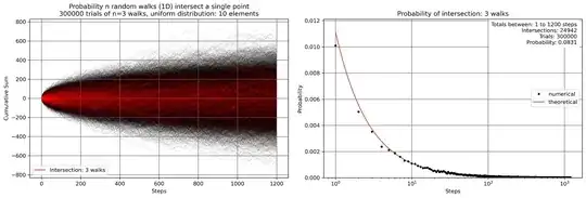

With help of Wolfram Alpha [3] the solution is found for $n=3$ meaning the probability of $3$ point intersecting random walks.
$$p(s)=\frac{1}{2 \sqrt{3} \ \pi \ \sigma^{2}} \cdot \frac{1}{s}$$
The total probability $p(n)$ is proportional to the reciprocal sum of $s$. So the total probability is proportional to the harmonic series:
$$p(n)=\frac{1}{2 \sqrt{3} \ \pi \ \sigma^{2}} \cdot \sum_{s=1}^{\infty}\frac{1}{s}$$
This series diverges, meaning there are infinate point intersections of $n=3$ random walks. So a matching cumulative digit sum of $\pi$, $e$ and $\varphi$ is not unique, probability $\sim 8 \%$ for the first 1200 digits (see graph).

import numpy as np
#Elements of digits [0,1,2,3,4,5,6,7,8,9] rescaled to fit random walk array=[-9,-7,-5,-3,-1,1,3,5,7,9]
#steps, in single random walk, x walks to intercept, number of trial to find intercept steps=2500 xwalks=3 trials=1500
#Set output array to zero count=np.full([steps],0)
for n in range(trials):
#Identify initial array, set total array to zero
w0=np.random.choice(array,steps)
w0=np.cumsum(w0)
total=np.full([steps],0)
#Select x random walk check for intercept
for m in range(xwalks-1):
    #Next current random walk
    w=np.random.choice(array,steps)
    w=np.cumsum(w)
    #Compare previous and current random walk
    eq=np.equal(w0,w)
    eq=eq.astype(int)
    #Count intercepts
    total=total+eq
    #Set current walk to previous
    w0=w
#Sum all interceptions for all trials
count=count+np.where(total==(xwalks-1),1,0)
#Print output print(count) print(np.sum(count)) print(np.sum(count)/trials)

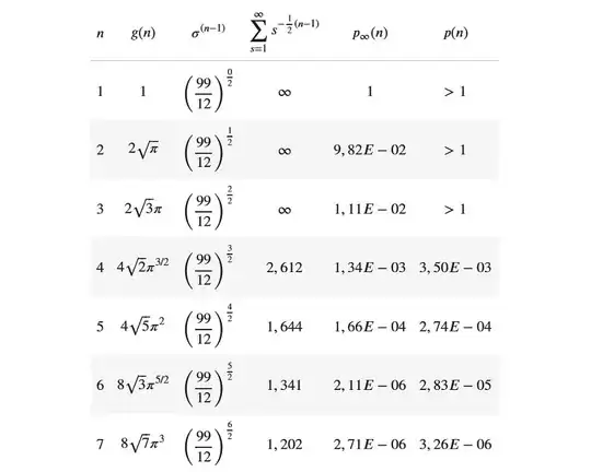

The probability $n$ random walks starting in origin (1D) intersect a single point can be calculated with:
$$p(s)=\int_{-\infty}^{\infty} \left[ {\frac {1}{\sigma {\sqrt {2\pi }}}}e^{-{\frac {1}{2}}\left({\frac {x}{\sigma }}\right)^{2}} \right]^n dx$$
Solutions have been found with Wolfram Alpha 1. This solution can be written as a function of the number of steps $s$. So the probability $p$ at $s$ steps can be calculated with a empirical found formula:
$$p(s)= \frac{1}{g(n) \cdot \sigma ^{(n-1)} } \cdot s^{-\frac{1}{2}(n-1)} $$
Where the function for $g(n)$ is found as:
$$g(n)=\sqrt { n} \cdot (2 \pi)^{\frac{1}{2}(n-1)}$$
The total probability over all steps $s$ is only dependent upon the $p$-series formed by $s$. This summation can be calculated with the Riemann zeta function:
$$\zeta(\small{\frac{1}{2}(n-1)} \normalsize) =\sum\limits_{s=1}^{\infty}s^{- \frac{1}{2}(n-1)}$$
$$p(n)=\frac{1}{g(n) \cdot \sigma^{(n-1)}} \cdot \sum\limits_{s=1}^{\infty}s^{- \frac{1}{2}(n-1)} $$

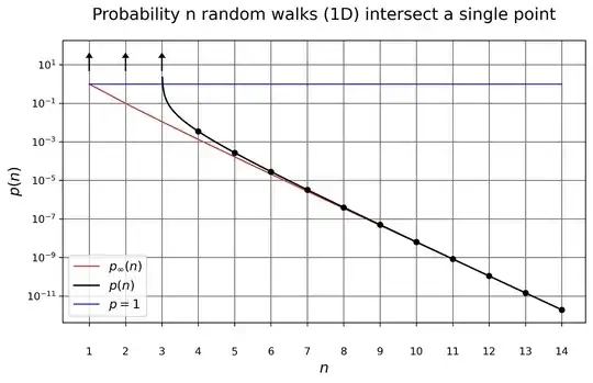

Graph information
Below a table and a plot for the probabilities of $p(n)$ point coinciding random walks (1D). Details:
  • The standard deviation is chosen: $10$ equal likely outcomes per step: $$\sigma=\sqrt{\frac{99}{12}}$$
  • For infinate random walks $n\rightarrow \infty$ the $p$-series converges to $1$. This probability is plotted as: $p_{\infty}(n)$.
  • $p(n)$ can be graphed as an continuous function.
  • Values $n<3$ have not been graphed while Riemann zeta $\zeta(<1)$ are resulting in negative probabilities.
Observations:
  • $n=3$ random walks have infinate single point intersections. $p$-series: $\sum\limits_{s=1}^{\infty}s^{-1}=\infty$, Riemann zeta: $\zeta(1)=\infty$ both have infinity probability $p(n)\rightarrow \infty$.
  • $n=2$ random walks have infinate single point intersections for $p$-series: $\sum\limits_{s=1}^{\infty} s^{-\frac{1}{2}}=\infty$ , interpretation Riemann zeta is unclear: $\zeta(\frac{1}{2})=-1.46035...$ resulting in a negative probability $p(2)$.
  • It is possible that $n\geq4$ random walks never point intersect. For $n=4$ only $\sim 0.35 \%$ of them will point intersect (with 10 equal likely outcomes per step).
  • The probability $p(n)$ plot of $n$ random walks (1D) intersecting a single point is directly related to the $p$-series. A relation with Riemann zeta is unclear while the number of walks $n=a+ib$ would be a complex number.

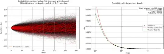

In my earlier answer I demonstrated how to determine the probability of $n$ intersecting random walks with $2$ or more likely outcomes per step. The method used a normal approximation making an error in the probability for small numbers of steps.
The probability of intersection for small number of steps can be calculated with an discrete method. By using generating functions, a solution is found and is based upon: SE.
The probabilities of a single random walk at step $s$ is determined by the coefficients of the generating function below. Where $d$ is the number of equal likely possibilities per step e.g. $d=2$ for random walk: $[-1,1]$:
$$\left( \frac{1}{d}x^{0}+\frac{1}{d}x^{1}+\frac{1}{d}x^{2}...+\frac{1}{d}x^{d-1} \right)^{s}=\frac{1}{ d^{s}} \left( \frac{1-x^{d}}{1-x} \right)^{s}$$
The coefficients can be calculated by applying the generalized binomial theorem. Where $n$ is the number of intersecting random walks. $p(s)$ is the total probability for an intersection occurring on step $s$:
Discrete method, $s<20$: $$\boxed{p(s)=\sum_{i=0} \left[\frac{1}{d^s} \sum_{r=0} (-1)^{r} \binom{s}{r} \binom{s+i-dr-1}{i-dr} \right]^{n}}$$
The discrete method is realistic for $s<20$ steps. For more than $s\geq20$ the normal approximation is more efficient.
An empirical formula was found see; my question and first own answer (confirmation here: SE). The standard deviation is determined from a discrete uniform distribution, growing with $\sqrt{s}$ per step while a random walk SE:
Continuous method, $s\geq20$: $$\sigma=\sqrt{\frac{(d^{2}-1)}{12}}$$ $$\boxed{p(s)= \frac{1}{\sqrt { n} \cdot (\sigma \sqrt{2 \pi})^{(n-1)} } \cdot s^{-\frac{1}{2}(n-1)}} $$
Both functions: discrete and continuous have been verified in a simulation. The intersections of $n=4$ random walks where counted. Random walks were used with $d=4$ equal likely outcomes per step $[-3,-1,1,3]$. The graphs show the discrete method is practical and accurate for $s<20$ the normal approximation is useful for $s\geq20$.
