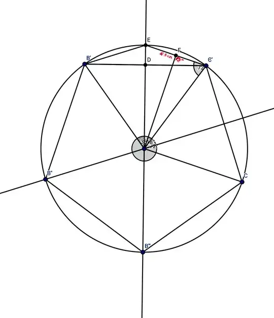

Approach to get similar result with inscribed initial polygon as PENTAGON will be as follows.Pentagon inscribed in circle.

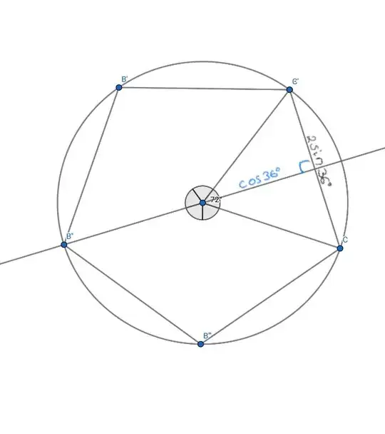

According to Chord in Trigonometry
  1. A perpendicular line from the centre of a circle bisects the chord. Or otherwise can be stated as, 2. The line segment through the centre bisecting a chord is perpendicular to the chord.
The length of the chord inside the unit circle for Pentagon will be $2\sin36^\circ$. Therefore circumference of Regular pentagon will be $5\times2\sin36^\circ$.
For the sake of simplicity let us apply rules which are basic
$$2\sin\frac{\pi}{5} = \sqrt{2 - 2\cos\frac{2\pi}{5}}$$
Now doubling the sides the length of the each chord inside the unit circle will be $2\sin(\frac{\pi}{2\cdot5})$ and therefore circumference of decagon is $5\cdot2^2\sin18^\circ$. where $2\sin18^\circ = \sqrt{2-2\cos\frac{\pi}{5}}$
Therefore circumference can be represented as $C_{10} = 5\cdot2^1\sqrt{2-2\cos\frac{\pi}{5}} = 5\cdot2^1\sqrt{2-\phi}$
(Here we get $2\cos\frac{\pi}{5} = \phi $, the Golden ratio)
Decagon

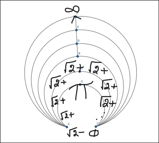

How to explain the fact that $\sqrt{2-\sqrt{2+\sqrt{2+...+\phi}}}$ is an infinitely small number different from $\sqrt{2-\sqrt{2+\sqrt{2+...+\sqrt{2}}}}$ another infinitely small number which is 5 times larger than the the first one? (By the geometric method we are deriving the value of $\pi$ from right side proceeding towards left to get the value of nested square root. (Computing also does the same). It seems that we should change the conventional thinking of representing infinite nested radicals in this respect. I need comments on this)
Infinite expansion happens between both ends. Can we call these as INFINITELY EXPANDING BALLOON NESTED RADICALS? Balloon nested radical(Bear with me for poor image quality)

  • Please go through the expansion of nested radical below 2nd diagram. Iterating by doubling from Pentagon to $5\cdot2^n gon$. Expansion of nested square roots of 2 happens between $\sqrt{2-}$ and $\phi$. This is what I have explained in the last diagram. – Sivakumar Krishnamoorthi Jan 13 '21 at 16:17
