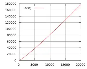

A first idea that comes to mind to define the factorial of a fractional number is interpolation: knowing the values at two successive integers, the values between these should be intermediate (looking at the "curve", you see that it is growing - very fast - but smoothly).
For instance, you could estimate that $3.1! = 3! + 0.1\times(4!-3!)=7.8$.
This does not look very accurate. By considering at the values of $\ln n!$, you see a trend much closer to a straight line.
So for better "accuracy", you can imagine that the curve is a exponential and do the interpolation on the logarithms: $\ln 3.1!=\ln 3!+0.1(\ln 4!-\ln 3!)\implies 3.1!=6.8921\cdots$
You can also increase the number of points use for interpolation, with the Lagrangian formula that computes a polynomial of a higher degree.
Anyway, this is quite empirical and does not lead to a satisfactory definition with interesting properties. Mathematicians have solved this differently: they found identities (such as the evaluation of integral $\int_0^\infty x^ne^{-x}dx=n!$) that can be shown to equal $n!$ when $n$ is an integer, and keep making sense when $n$ is not.
So they started using this as a definition of the factorial
$$n!=\int_0^\infty x^ne^{-x}dx.$$
With this formula, you get $3.1!=6.812622863\cdots$
Extension to negative values is yet a different story. If you consider the recursive definition of the factorial, $(n+1)!=(n+1)n!$, which allows to compute larger and larger values, you can reverse it as $(n-1)!=\dfrac{n!}n$. Going backwards, you get to the negatives. Then, you will have a surprise for negative integers...
