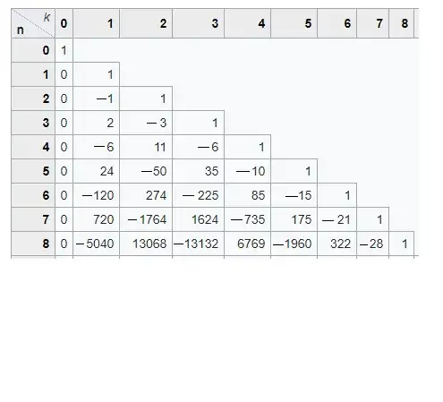

I found the answer after a while. The coefficients are calculated using the signed Stirling numbers of the first kind.
These are the signed stirling numbers of the first kind enter image description here
In order to get the coefficients you select the row by the degree of the polynomial and read it from right to left.
To calculate it, the facts I used were
$$s(n,k)=-(n-1)\cdot s(n-1,k)+s(n-1,k-1)$$ $$s(n,n) = 1$$ $$s(n,0) = 0, n >0$$
And what is interesting is the polynomials that I found $1,\frac{n(n+1)}{2},\frac{(n-1)n(n+1)(3n+2)}{24},\frac{n^2(n+1)^2(n-1)(n-2)}{48}$ describe the diagonals.
So for instance $\frac{n(n+1)}{2}$ is the diagonal 0,1,3,6,10,15,... (at positions (2,1),(3,2),(4,3),...)
And another example would be for $\frac{(n-1)n(n+1)(3n+2)}{24}$ where the value on the diagonal are 2,11,35,...
So a future follow up question would be is there a closed form for the diagonals of the stirling numbers of the first kind?
