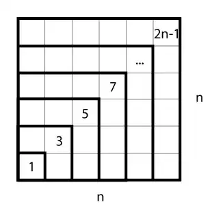

Hoo boy. You're in for a treat; this theorem was known to Pythagoras and his disciples.
Theorem: The sum of the first $n$ odd numbers is equal to $n^2$.
Proof: By picture.
The original image is part of a page containing two proofs of this identity: http://www.9math.com/book/sum-first-n-odd-natural-numbers. It is not mine.

1I like this proof, essentially is the telescopic sum argument $\sum (2k-1)=\sum [k^2-(k-1)^2]=n^2$ – Gaston Burrull May 20 '13 at 02:41
AoPS has another picture, not exactly this one: http://www.artofproblemsolving.com/Wiki/index.php/Proofs_without_words. – Gyu Eun Lee May 20 '13 at 02:46
