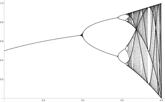

Suppose let's say we have a recursive function, $$x_{n+1}=rx_{n}(1-x_{n})$$
From what I understand, the $x_{n+1}$ VS r graph starts to split (bifurcate) after a particular value of r (apparently it's around 3). Does that mean after they split up, we will get two values of the function for the same value of r? Am I getting it right? bifurcation diagram
How's it possible? (I do understand that it loses its ordered nature and falls into chaos) Could someone illustrate it with an example? Help would be appreciated! (I'm a high school student, so explaining it in simpler terms would be even more appreciated). Thank you!

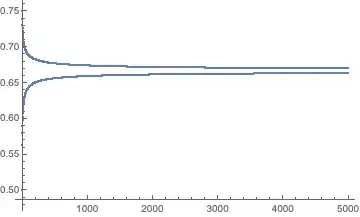

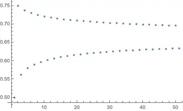

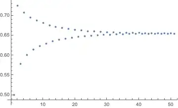

At $r=3$, the terms get closer together, but do so way more slowly - from the first $50$, it is not even apparent that they converge:
If we look at the next $5000$ terms, we can see they continue to get closer together:
And, if we do a bit of mathematics, we can find out that the sequence eventually converges to $2/3$. The sketch of the argument is to observe that if $x_n < 2/3$ some algebra can prove that $x_n < x_{n+2} < 2/3$ and a bit of analytical work can show actual convergence of $x_n$ - and we can even estimate the rate of convergence if we like.

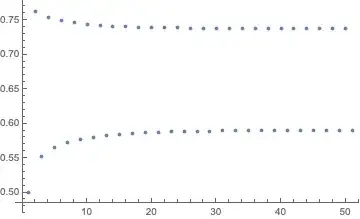

If we keep increasing $r$, strange things start happening. At $r=3.05$, for instance, the terms don't get closer together:
Rather quickly, the terms settle into a pattern of alternation between a high value and a low value - and then don't move any more. The long term behavior here would be described as a two-cycle, where two values keep alternating - and you could find explicitly where that occurs by using the recurrence to solve the quadratic equation $x_{n+2}=x_n$.

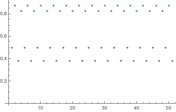

Continue increasing more, say to $r=3.5$, and you get a pattern of four values:
And if you sort of start working in smaller and smaller increments of $r$, you find a pattern of eight values, then sixteen and so on - followed by, eventually, cycles of every length (appearing in the same order - and not by coincidence - as described in Sharkovskii's theorem). The last kind of cycle to appear (and of the major events one sees on a bifurcation diagram) is a three-cycle, which appears near $r=3.83$ and gives behavior like:

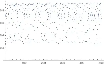

Where we see three values. There are also values of $r$ that display more complicated behavior that never becomes cyclic - although this poses certain problems in trying to get a computer to accurately plot it. One can get a taste of this sort of thing at $r=3.675$, which gives the first 500 terms as:
There's certainly some patterns - we can see a few shapes repeating irregularly in the middle - but it's not clear that a cycle is emerging (or will emerge). In fact, somewhere near this $r$ value there are some points that are easy-ish to prove do not tend to periodic behavior ever for most starting points $x_0$. This fact is also easy to show at $r=4$, but I promised to start my plots at $x_0=0.5$, and that starting point is not interesting at all at $r=4$.
Now, let me get to your question: a bifurcation diagram tries to display the information contained in these plots over a lot of $r$ all at once. Basically, it reduces each plot to a single vertical line, and plots on that line the values that appear in the long term behavior*. So, for $r\leq 3$, only a single point belongs on the bifurcation diagram, meaning that most points** tend there in the long term. In the next region, we see two points, meaning most points end up alternating between those two points in the long run. So, each vertical slice tells us what the sequence does after a lot of time for a fixed value of $r$ - and, as you can see, this is quite complex. A crucial point here is that the bifurcation diagram isn't trying to show a function - each vertical slice is essentially a distribution*** saying things like "the sequence will spend half of its time on the upper branch and half on the lower branch" or other such statements about behavior more complicated than identifying a single value of interest.

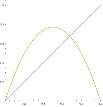

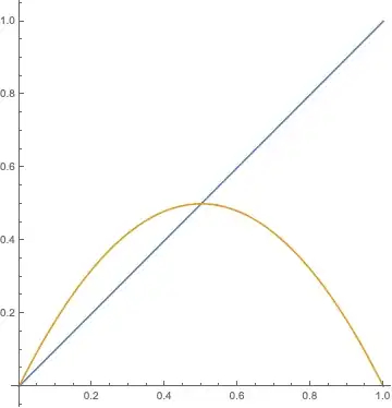

As to why it does that, it helps to define $f_r(x)=rx(1-x)$, which is a function defined to run one step of the iteration. There's a lot to say, but the basic idea is that if you plot this function for $r=2$, you get something like this, where I also plot the line $y=x$:
For this value of $r$, the iteration converges very quickly to $1/2$ - and we can see that, if we started at exactly $1/2$, we would end up exactly back there - which is called a fixed point. More strongly, however, this fixed point is attractive meaning that if we start near 1/2, we end up closer after one iteration - one can see this by the fact that the value of the function changes very slowly near the fixed point - it's just a big flat top, all of it mapping closer and closer to $1/2$ than we started. This leads to very fast convergence of the sequence.

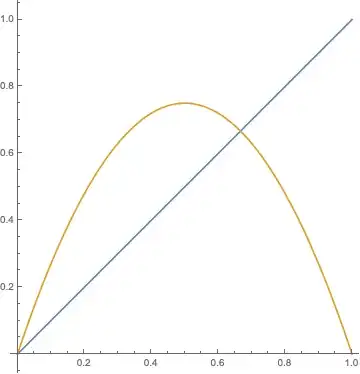

The plot at $r=3$ looks different in substantial ways:
Note that there still is a fixed point - at $2/3$ now - but the behavior of things near $2/3$ is different. The slope of our function $f_3$ near that fixed point is $-1$ - meaning that if we start at $2/3+e$, the next iterate is around $2/3-e$, meaning we didn't get meaningfully closer - although if we look at a quadratic approximation, we can see that we are getting closer, just way more slowly.
At $r=3.1$, the slope near the fixed point is now greater than $1$ in absolute value - meaning if we start to near the fixed point, we actually end up further away after one iteration - this is called a repulsive fixed point.
This is why the behavior changes - it can't be that most points end up at a repulsive fixed point****, so something else must happen. On the plot, we see two branches emerge, so let's consider that.
If we increase $r$ a little more to $3.3$ and plot $f_3(f_3(x))$ as a third line, we get to see a bit more about why now a two-cycle prevails:
While the orange curve ($f_3(x)$) continues to get steeper and steeper near the fixed point - preventing the simple convergent behavior, the green curve ($f_3(f_3(x))$) crosses the $y=x$ line in two other places - and is fairly flat near those locations, meaning that, if we start near one of those places and advance two iterations, we get closer to where those lines cross the $y=x$ line - leading to an attractive two-cycle between the values of those intersections. As we increase $r$ further, what happens is that these new intersections get steeper and steeper until they become repulsive - leading to larger cycles (and eventually to chaotic behavior - but that's really hard to explain in a short post).

That's not quite what this graph represents. For any given values of $r$ and $x_n$, the formula defines $x_{n+1}$ uniquely . In other words, given $r$ and an initial value $x_0$, the sequence $(x_n)_{n\in\Bbb N}$ is well and uniquely defined for all its values.
Now, given a sequence, there are things we may ask ourselves about it.
Does it converge, and if so, to what value? How fast?
If it does not converge, does it have accumulation points? Which? How many?
The graph plots on the horizontal axis the parameter $r$, and on the vertical axis the values that are asymptotically visited by iterates of almost all initial conditions $x_0$ (for that parameter $r$).
We see that up until $r=3$, we get a straight limit (which is why we see only one value in the graph), but thereafter behavior changes. Just after $r=3$, we see that the iterates actually oscillate between two values (which is where we get the bifurcation from). Up ahead, the iterates then oscillate between $4$ values. This doubling continues, coming in faster and faster, until behavior changes again.
We get values of $r$ for which the behavior is chaotic, meaning slight changes in the initial conditions $x_0$ yield sequences whose iterates behave in a vastly different ways long term. Even then, among the chaos there are short 'bursts' of order; in fact, for any value of $P$ there is some $r$ such that the iterates oscillate between $P$ values.
Fimpellizzeri
  • 23,321
  • Thank you for taking the time. But since they oscillate between two values, shouldn't the graph be in a zig-zag manner? why do they branch instead? – basilisk Dec 29 '20 at 05:59
  • @dobby they branch because zig-zagging would mean that the value at which it rests oscilates as r increases. That is not what occurs. What occurs is that instead of resting at a single value for a certain r, it bounces between 2, thus having two "resting values" for that single value of r. – Neptune Dec 29 '20 at 06:18
  • @Neptune Yes.. I just realised it after reading the other answer. Thank you anyways! – basilisk Dec 29 '20 at 06:28
