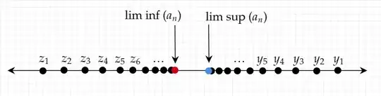

(c) $(y_n)$ and $(z_n)$ are convergent sequences; their limiting value is the infimum/supremum. So, we are justified in setting, \begin{align*} y &= \inf \{y_n:n \in \mathbf{N}\}\\ z &= \sup \{z_m:m \in \mathbf{N}\} \end{align*}
Observe that, the infimum of $k$-tail of the sequence is always less than or equal to the supremum of the tail. Hence, $z_k \le y_k$ for all $k \in \mathbf{N}$.
The visual representation makes it clear that, every $y_n$ is an upper bound for the sequence $\{z_m:m\in\mathbf{N}\}$. So, $\inf \{y_n:n \in \mathbf{N}\}$ is also an upper bound for the set $Z$. Thus, $\liminf a_n \le \limsup a_n$.

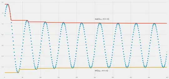

Consider the sequence \begin{align*} a_n := \left(\frac{n+1}{n}\right)\sin\left( \frac{n\pi}{8}\right) \end{align*}
This sequence is bounded, but not convergent, and so a strict inequality holds.

import numpy as np
from matplotlib import style
import math
The sequence x_n = (n+1)/n sin(n/8)
n = np.linspace(1,500,500) x_n = np.multiply(np.divide(n+10,n),np.sin(n/8))
The supremum of a subsequence
def sup(x_m,n): return max(x_m[int(n-1):])
The infimum of a subsequence
def inf(x_m,n): return min(x_m[int(n-1):])
limsup = [sup(x_n,m) for m in n] liminf = [inf(x_n,m) for m in n]
plt.style.use('fivethirtyeight') plt.figure(figsize=(20,10)) plt.xlim(0,450) plt.text(250,1.2,r'$\sup {x_m: m > n}$') plt.text(250,-1.2,r'$\inf {x_m: m > n}$') plt.plot(n,x_n,'o') plt.plot(n,limsup) plt.plot(n,liminf) plt.show()
