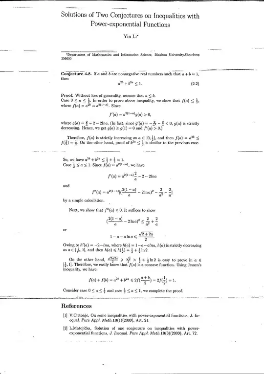

Not having a good day with websites. I have downloaded what seems to be the source of the question, a 2009 paper by Vasile Cirtoaje which is about 14 pages. Then a short answer, in a four page document by Yin Li, probably from the same time or not much later. The question was posted on MO by a selfish guy who knew the status of the problem but was hoping for a better answer, a complete answer was also given there in 2010 by fedja, https://mathoverflow.net/questions/17189/is-there-a-good-reason-why-a2b-b2a-1-when-ab1
I have both pdfs by Cirtoaje and Li, email me if you cannot find them yourself.
This is not a reasonable homework question, so I would like to know more of the story, what course for example.
Yin Li of Binzhou University, Shandong, 2009 or 2010, excerpts I believe he just spelled Jensen's incorrectly, see JENSEN
